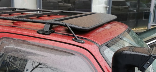

25 Mar 2020 19:14 - 25 Mar 2020 19:22 #220264
by furo
Replied by furo on topic CB Antenna Placement
Thank you for your help everyone. I have installed the CB with the Zetagi splitter and wired it all in. The only outstanding issue is the antenna, and I have a question about that: the current aerial is at an angle (as in the picture below), but all CB antennas I've seen are vertical. If I installed an antenna at an angle would that cause major problems? I'm not too bothered if my range is a little reduced.
If it is important for the antenna to be vertical, are there any easy solutions for this? The aerial base has an M6 bolt connection and I have seen some Scania antennas can be attached directly to this. Is it possible to bend an antenna so that it is vertical, or would that cause damage?
Last edit: 25 Mar 2020 19:22 by furo.
28 Mar 2020 06:52 #220347
by kirkynut
Replied by kirkynut on topic CB Antenna Placement
Are you talking about the CB aerial that is now the only working aerial being at an angle?
If so I can't see why it will be an issue as long as it is not so low to whip anything or anyone.
