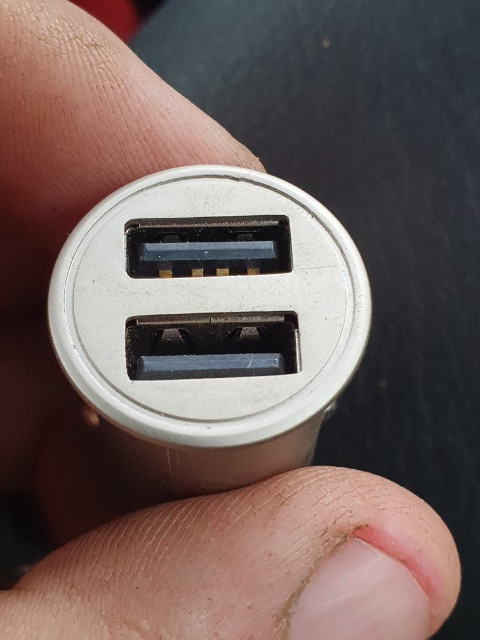

Here is the inverter i use:
So i have this pligged into my ciggie port. All i do is charge my mobile. Or at least i did when it went flat last.
Can tou chaps recommend a decent battery anlyser So i can check the battery?
I have made a hard rule feom now on. Any kit i buy for the jim is going ro be the very best quality i can afford. I am sick of buying second rate gear and having to replace it for the real deal some days, weeks or months latwr. I'll get all the kit i need more slowly as i am not madenof beer tokens, but buy once cry once, biy cheap buy twice. I kbow you guys understand this!!
So first port of call, is to check the condition of said battery. Roger that!
Cheers fellas!!
Cheers fellas!!

Part of the problem is that in order for the accessory socket to be live the ignition has to be in the accessory position so the radio is powered even if it is not on and the majority of the rest of the cars system is also effectively in standby not off so even though all you are doing is charging a phone you have quite a load on your battery. Additionally by using an inverter there is a an additional drain from it as well as anything plugged into it and you are adding inefficiencies in the form of heat. Using a a high amp accessory to USB adapter removes much of that inefficient battery use and is also more compact in a Jimny.
