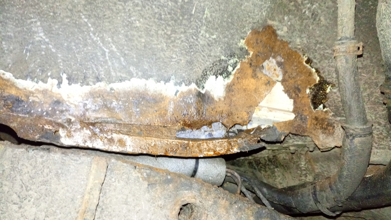

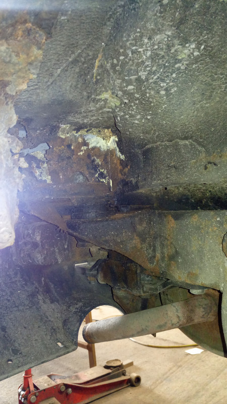

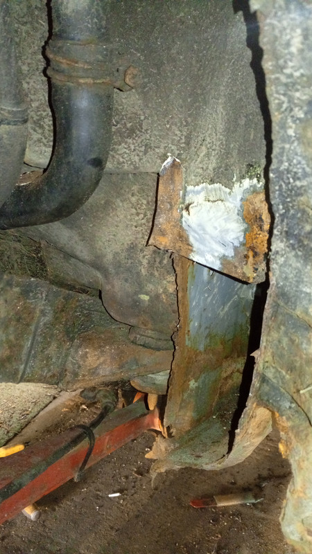

22 Feb 2020 16:27 #218888
by Reason2doubt
Replied by Reason2doubt on topic MOT: In need of moral support
Quick update for those interested.
Lights are fixed, emissions are sorted and wheel bearing has been replaced.
The car is currently being examined by a fantastic local welder (he's 70, and isn't phased by the work at all)
The MOT tester was justified pointing out the rust - it is bad however not necessarily in the places that have been noted on the test.
Sills are going to be sorted out quite easily, they are actually perfect on the outside. Just the inner sills to fix which seems to be the easiest job.
The rear body mounts are completely rotten, as well as the rear part o the arches and body. This includes where the rear arches meet boot floor.
I am perfectly happy for the guy to fix this for me - he's quoting me £500 for both body mounts, the arches, boot floor connection and the sills.
Now, why might I still be annoyed? Well, the boot floor, arches and body mounts were originally (last year) "fixed" by KAP Suzuki - that lying bastard bodged the whole job. The boot floor has been stuck in using some kind of silicon/tar gum. The body sitting on the body mounts was tacked together using the thinnest metal I have seen and again, covered in this black rubber shite. For this privilege I paid Darren KAP Wilson (supposedly a Jimny expert) £600 in total - the robbing b*stard completely ripped me off. He didn't ever tell me how bad it was originally, which is why it has still failed now and we are now removing all of his "welding work".
