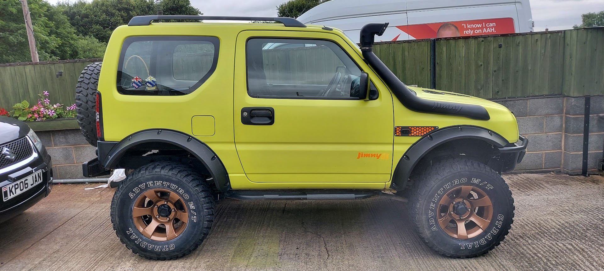

Replied by Lambert on topic Extended Arches Query
Legally you shouldn't be able to see the actual tread of the tyre, as in that part that contacts the road in normal driving, when looking vertically down from the widest point of the wheel arch. It is acceptable to be able to see the side wall of the tyre. As to where you would find some Ebay might have something second hand or generic as for specific fitting I think user keithy periodically moulds sets and they look good too.

Replied by jackonlyjack on topic Extended Arches Query
I do like those Chinese arches and they might give me enough space for
750R 16's :woohoo:
750R 16's :woohoo:

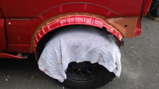

21 Dec 2019 12:13 #216667
Yes to fit the ebay one's you will have to remove old arches and sill covers
Chop out the front arch also remove part of rear arch
this bit with the bumps in it
