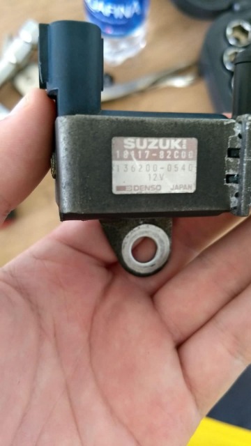

I am needing some help with getting my Jimny to run. There is a part of the Fuel injection system that when it is on the Jimny will not really idle but when we take it off it will idle. It seems to be some type of air inflow sensor but I am not familiar with the electric systems. Attached are pictures of the part and where it is located on the engine. If anyone has more experience and knowledge with this part or system any input would be appreciated thank you.

Also this part gets pretty hot when trying to start the engine so it makes me believe there is some kind of blockage causing pressure or something possibly?

What year Jimny is that, because it doesn't look like an engine I recognize?

1991 ja11

Ah right well that is way before my time so can't really comment. Has you googled the part number to find a replacement, only I agree that its probably not supposed to get hot when starting.

I have .. everything comes up in Japanese which if I need to ill just use a google translator for the page or something but thought i would try get some insight if possible from someone who has worked with them and knows the system.
