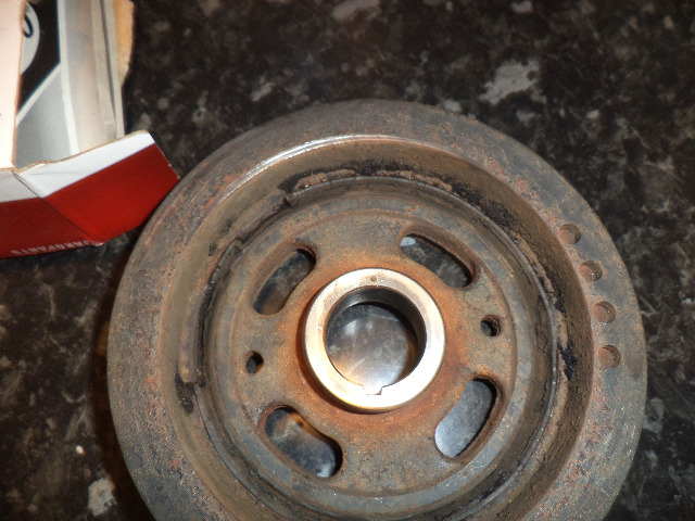

31 Aug 2019 12:57 #212913
by gilburton
I started off high and worked my way down ever since
Replied by gilburton on topic Can anyone ID this noise??
All sorted. THanks for the parts Martin almost as quick as Amazon lol
Yes it was the crank pulley delaminating so I got to it in time and also fitted new belts while I was at it.
You can see where it had been rubbing on the crankshaft seal housing but no damage.

31 Aug 2019 15:14 #212918
by gilburton
It certainly is I could push the inner using my thumbs so it wasn't far off coming apart and the noise was a warning.
