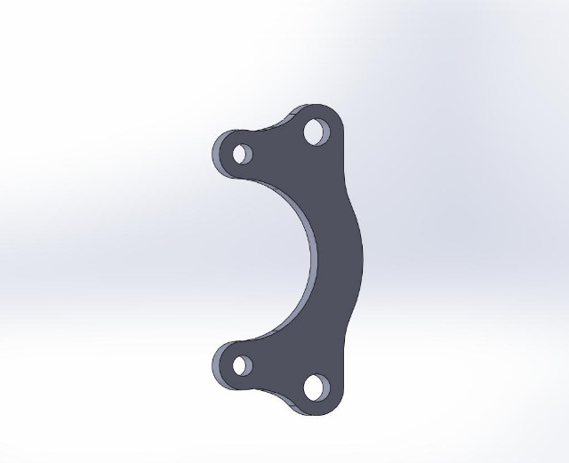

01 Jun 2019 08:08 #209369
by Keithy
Replied by Keithy on topic Mono bloc calipers
Due to the shortage of early Vitara calipers to allow fitting vented discs on the front.
I drew up a bracket so that Golf 2.0TD calipers could be used...cheaper to buy new calipers than pry some early vit calipers from someone......and they usually require a rebuild anyhoo.
Essential for spirited driving and 200hp+ Jimny's
- Posts: 9947
- Thank you received: 1988
01 Jun 2019 08:45 #209370
Replied by Lambert on topic Mono bloc calipers
And they then run the ventilated diesel front disc?
01 Jun 2019 10:04 #209377
by kirkynut
Replied by kirkynut on topic Mono bloc calipers
I'd only be after the brackets and would buy new calipers anyway.
01 Jun 2019 10:10 #209379
by Keithy
Exactly.....new genuine ebay calipers and a pair of vents....done.
Lambert wrote: And they then run the ventilated diesel front disc?
