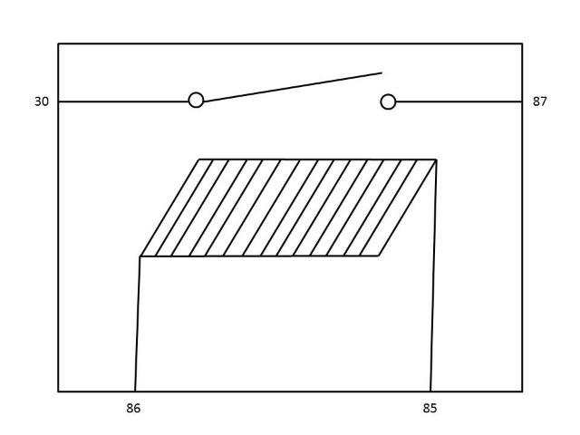

OK. This is a little crude but should explain differences in relay pin connections on different diagrams that people post.
I will preface my comments that this applies to the relays that most people get with their spot lights but doesn't apply to the less common relays with built-in diodes
Relays are relatively simple switches that allow a low current circuit to activate a higher current rated switch. As shown in the picture, pins 85 and 86 are part of the low current circuit that, when current is applied, excites the coil creating an electromagnet that closes the switch between pins 30 and 87......easy. When that is done, a positive and negative connection attached to pins 30 and 87 becomes a completed circuit.
Now the important part for people that are becoming confused when they see different connection schemes from various sources:
Relays do not care about polarity (except for the ones with diodes). They are simple switches. All that needs to be remembered is that 85 and 86 work together and 30 and 87 work together.
The positive side of a circuit can be connected to pin 85 with negative attached to pin 86 or those can be reversed. The same is true of pins 30 and 87.
I will freely admit that this information is from lessons long passed. I will defer to anyone who has greater knowledge.
In the end, I hope that this helps clear some confusion rather than creating more.

15 May 2019 19:14 #208056
Replied by yakuza on topic Jimny Spotlights
Done this now, works fine.
But couldn't get the light in the switch to work.. Not important of course but would be nice if the switch lit up when the lights did.
Hooked ground to it but it just went bananas.

Yakusa:
You have me curious now. I actually plan to do this same arrangement with my Jimny. I have given some thought about whether I wanted a lighted switch or not but haven't decided. I think I need to go back to the diagram and give it some additional thought.
