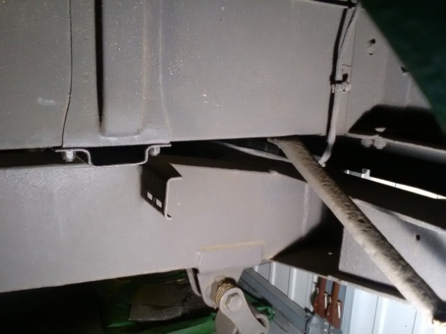

It comes in two colours, black and clear. I can find no evidence to suggest they are different other than colour, but I find the black will dry to a hard black wax finish which has some resistance to scraping etc. It can not be removed with a power washer etc. Having set it is hard but it can be removed with white spirit at a later date if required. I have extensive experience of its use on my Series Landover and find it provides good protection. It is easy to apply as an underbody spray which initially will "creep", but once dried will protect from water/mud etc.
I use my Land Rover on pay and play off road sites and the Waxoyl has not been removed by loose mud or ground etc, but stone to metal contract will scrape it off (as it would any finish). But when you get home after cleaning and a dry it's easy to re-applied a new layer over the damaged area if needed.
Here is a picture of the rear chassis behind rear wheel of my 1960 Land Rover showing the wax finish. It's sort of none stick so the mud just washes off. It was applied about 10 years ago and it's stood the test of time, but probably due for a top up.
I would not use it in box sections or cavities as it dries too hard. Some have also reported that the clear will eventually dry out totally and separate from the metal it is trying to protect, but as underbody protection Black Waxoyl is perfect in my humble experience. Waxoyl in the UK is a bit like Marmite (black food spread), some like it, some don't.
Having said that like any finish it's only as good as the preparation.
