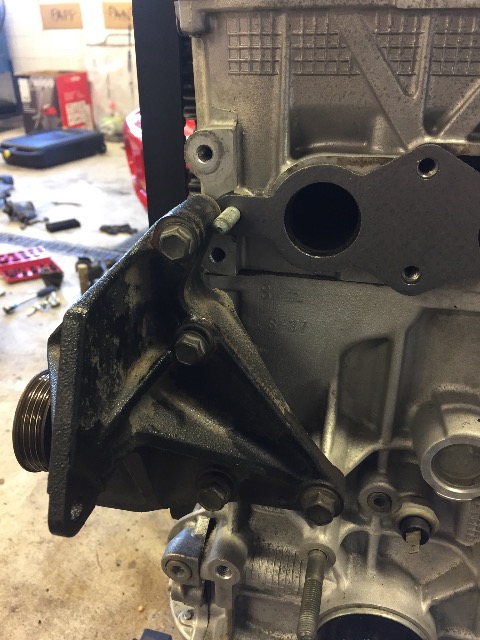

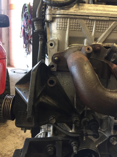

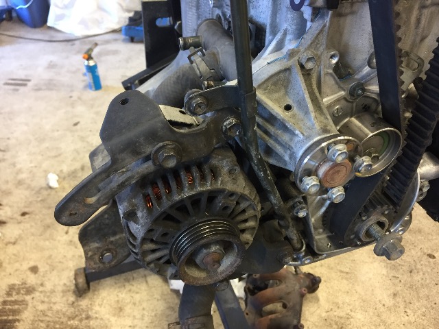

Brackets..
what steering pump and generator bracket to use?
Jimny one doesn't fit, but will the baleno clear the frame rails?
