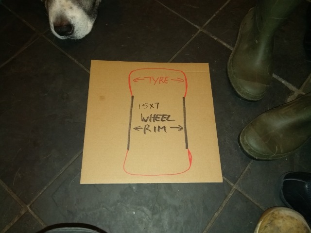

A 205 width tyre will fit 7" rim But the tyre wall will be more straight up no tyre bulge so you could catch your rim on curb
offset is on the wheel as ET..ET 0 is standard size meaning your wheels are 15" x 5.5J....J meaning wheel width 5.5"
So -7 et means wheel will stick out towards the arch edge by 7mm....ET-15 wheel will stick out 15mm further than standard wheel

Here's a crap picture to explain
Nuts not sure without seeing what hold's your wheels on
