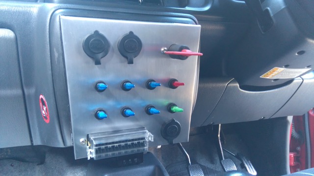

jackonlyjack wrote:
When all screws removed it just pulls out
Be very careful the wire will be attached to fag lighter socket and very short
this was my effort and my hand doesn't catch any of it ;)
Right what do all the switches do?
04 Dec 2018 17:19 #198634 by jackonlyjack
Replied by jackonlyjack on topic fascia removal
Radio,cb,land metre light,rear work lights,2low (no longer needed manual hubs now)
and three spares all have their own fuses
2 sockets switched power and other constant live
and the big red key isolates the whole switch panel
