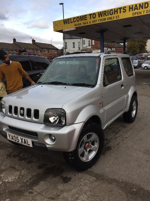

22 Nov 2018 19:06 #198023 by sniper
Replied by sniper on topic New jimny
If your going +2" lift, then as jack says -30 all the way......
This is mine with the spacers on and 215 BFG AT KO2 tyres.
The sidewall of the tyres just peeps out of the arches but all tread is inside. Cracking tyres by the way, improved on the old ones, especially in snow.

22 Nov 2018 19:53 #198024 by jfkenpoman
Replied by jfkenpoman on topic New jimny
sniper does yours have a 2" lift in the picture?
22 Nov 2018 20:14 #198026 by sniper
New standard height springs with 15mm seats......
sniper
