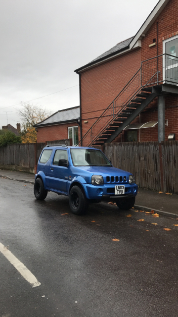

Hi everyone,
Got my 03 Jimny last week and loving it, having done 95K miles and there not being really any service history I have been doing a general fluid change for the entire car. I plan on taking it down to France for the winter season and am keen to change the head gasket before I go, it’s not showing any signs of being blown but for peace of mind and for future ownership I want to know it’s good and won’t potentially blow. I have some experience with bits and bobs but don’t have the tools or experience to change one on the M13A with the chain drive. Garage costs are looking to be £350 plus the gasket at £80. Does anyone on here know anywhere that could do it reasonably or themselves has the tools and would be keen to lend a hand, I’m based down in ALTON Hampshire but would be willing to travel some distance to get this done.
Second question, there is a sheared rocker cover bolt on my engine and the remaining bolt sits below the top of the shoulder, it’s the back right and really hard to get above. Does anyone know if you can replace the threaded stud in the cylinder head or is the only option to drill it out and re tap the hole. In my efforts to remove it have kind of mashed up the thread above it.
Sorry for long post, but thanks for any of your responses!
Cheers!

blue is the best,,,

Certainly Is a great colour
