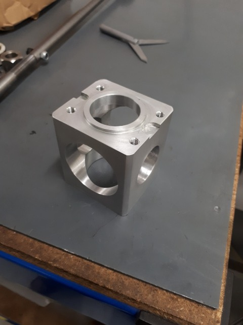

Well i'm an automotive engineer and have free access to a CAD package for the design work, and fortunately i work at a place where i can use the kit for my own purposes and we've got some really good contacts to get small stuff made cheap/for free. Should have a nice CNC machined billet spacer for the gearstick coming today/tomorrow

Just did a quick calc and the new gearstick should give me the choice between a maximum leverage ratio of 4.82 and a min of 3.69. The standard gearstick had a ratio of roughly 6.29 giving a throw of 122mm. This means that the throw of the new gear knob will be reduced by between 24% and 41% (also giving an equivalent increase in required gearstick effort). I've not driven a vauxhall Omega but i've seen anecdotal evidence that the standard gear change is sloppy and not very nice. With this in mind hopefully the new setup will be tune-able to a much nicer feel whilst giving me the 'defender' look i was going for.

Gearstick is ready for a trial fit so I can make sure it works properly and put a bend in the bar to get the gear knob in the right place. Quite chuffed with the spacer block, especially as it was FOC.
