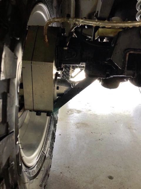

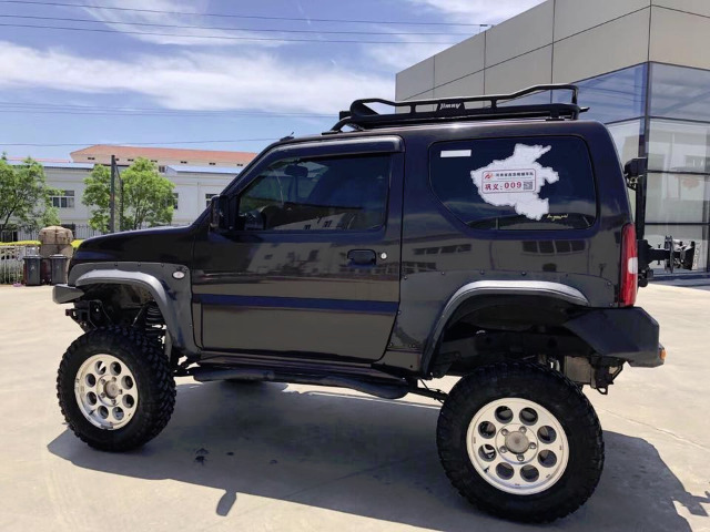

.....somewhere in Japan. Portal axles for the Jimny. I always wonder how much true engineering goes into projects like this. I think I remember seeing someone come up with portal axles before but never saw anything commercial come from it. The information was in Japanese so I'm not sure if this is a backyard blacksmith job or a production effort.

That's cool. I have long wondered why its not a more common thing.

The price must be horrendous. Unless they are chain drive they need an idler gear, or the axle has to run backwards.

From what I read they were horribly expensive and proved unreliable. I have a vague recollection that it was someone in Russia,

They don't look like anything I've seen. Not keen on that bracket. Kind of detracts from the clearance.
Here are some Russian ones using old army surplus.
sites.google.com/site/voit4x4/
Then there's Tibus
www.tibus-offroad.com/en/products/bolt-on-portals/suzuki/
I think the early Unimog 404 & 411 are too heavy and the pinion is too long.
I have to collect my shortened ones this weekend. Gonna need an engine hoist.
The later U1300 are modular in 5 pieces and with a much shorter pinion but are even heavier
G wagon ? But what price ? Then again how much for a decent 4" lift. Take that away from the G wagon axle & add on fabrication.

There's a chain in the Jimny transfer box, unless you now have a Rocklobster.
