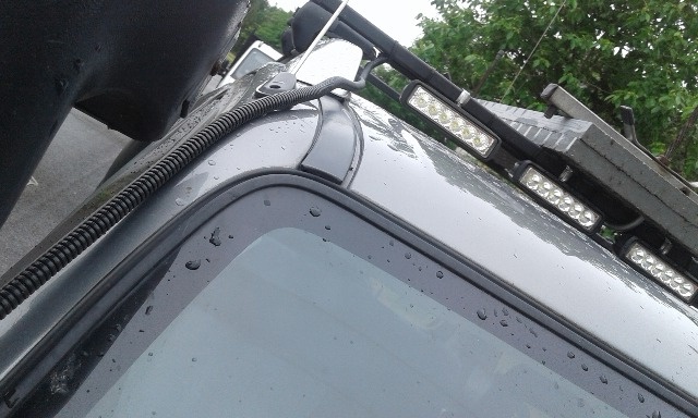

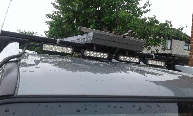

Got to say I think it's the luck of the draw with the Chinese stuff can't remember where I got mine from but thet were cheap, still look good as new and work great, regularly blasted with the jet hose and no problems so far, I ran my wire down the snorkel in some ribbed tubing and cut a slot in the plastic just behind the bonnet.
Can't attach a pic for some reason
