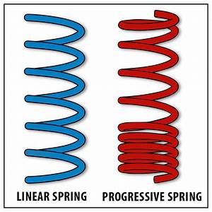

i have came across the PROGRESSIVE SPRINGS has anyone tried them on jimny they seem quite good and extendable so more articulation.

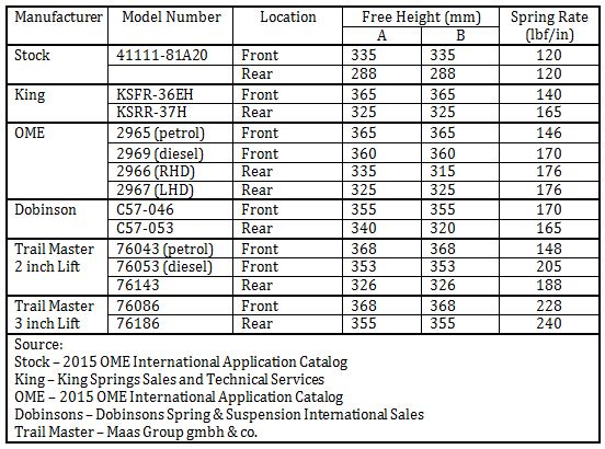

I have OME with the front being for the diesel Jimny. I also have steel bumpers but have found the diesel springs to be a little too stiff. I will likely change to the petrol springs designed for use with a bullbar. The Trailmaster that Martin sells would definitely be on my short list of choices. Just for reference, this is a table I created a while back for comparison. Martin has also inserted it into one of the wiki articles.
