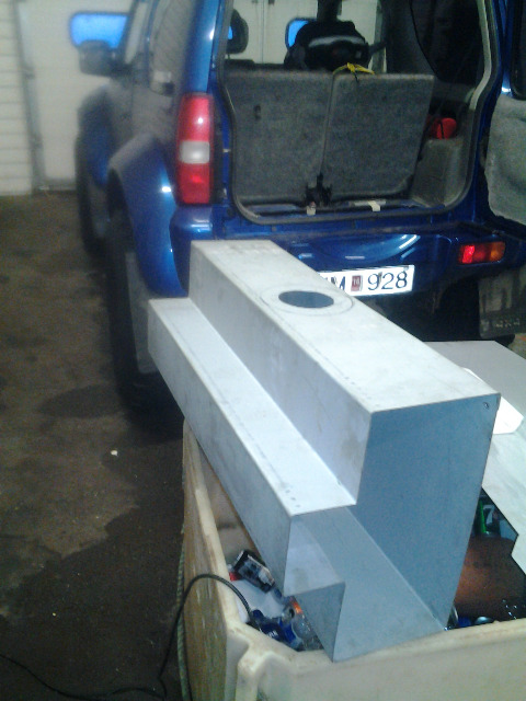

Hello there, I just read this thread about expedition tanks.
Well what I did is not called easy way, but I decided to share my aux tank with you guys anyway.
The tank is about 70 liters, and is located behind the rear axle, I got 6 cm bodylift so extra space is between body and chassis.
I removed the exhaust at the rear, and it is now on the side.
Total capacity is now about 110 liters, wich is awesome.
I use a fuel tank switcher from a Ford, it switches the fuel pumps, tank gauge and piping, with only one button, so you can even switch tanks when driving.
