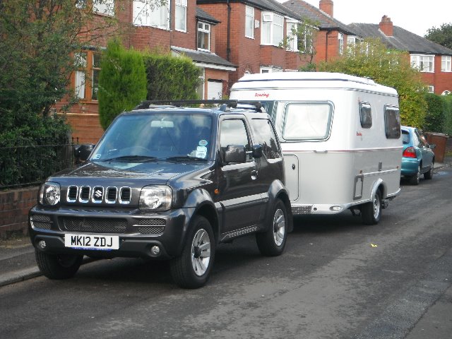

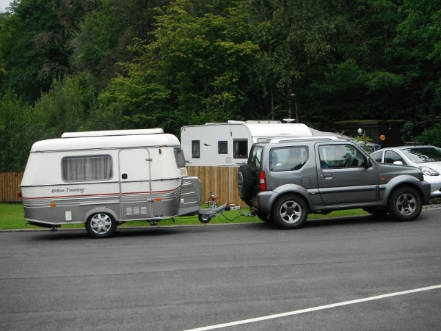

I use to have a small Eriba Puck at 500kg MTPLM and this combination was great, after a few years I upgraded to a larger caravan of the same make an Eriba Familia 320 @ 900 MTPLM, Whattow car website suggested that my Suzuki Jimny with a 83 bhp /110Nm torque engine towing the Familia should be ok with a car to van ratio at 79% but it would be sluggish up hills.
In the real world when towing it became obvious that I had to sit behind slow moving traffic on the motorway and constantly change gears, I also had to wait for very big gaps before pulling out of junctions and roundabouts. I was in no rush to get to my destination however I found that the journeys became tedious and very fraught. The deciding factor to trade in my Jimny was on the M62 going up the large hill from Manchester to Huddersfield in the crawler lane in 2nd gear.

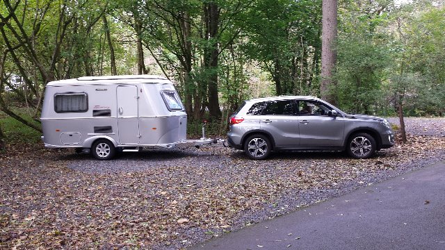

The car I have now is a diesel 2015 Vitara AllGrip @ 118 bhp 320Nm torque (its the Nm torque figure that caravaners look for to give low down grunt) with a car to van ratio of 59% and it makes a massive difference. I now have the confidence to overtake and pull out of junctions, which means that I am reaching my destination less stress free. It's a fine balance of having a car that is up to the job for towing and not over the top for everyday usage...
Try this outfit matcher to give you a rough idea.
towcar.info/GB/index.php
I really miss my Jimny, I had 4 over a 12 year period, I am hoping that the new Generation 4 model will have a more powerful engine.
