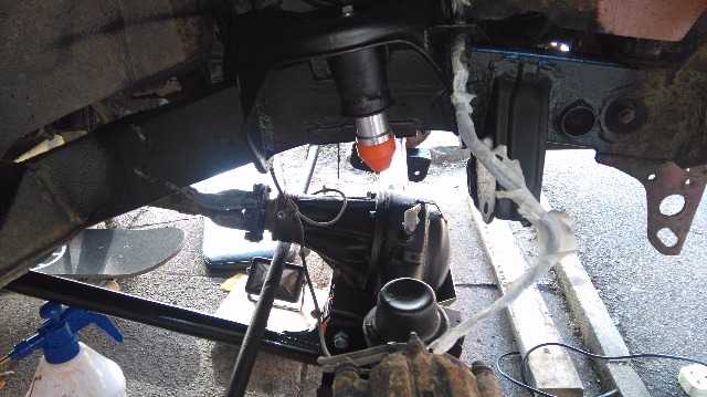

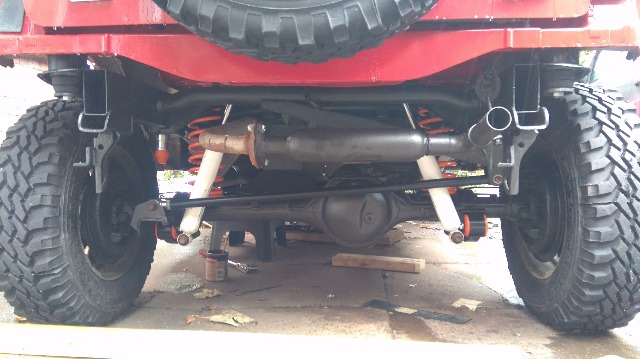

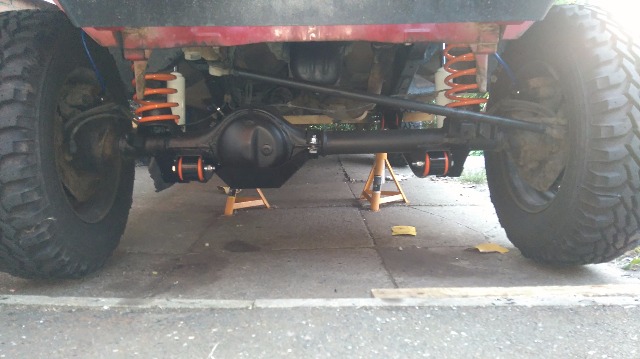

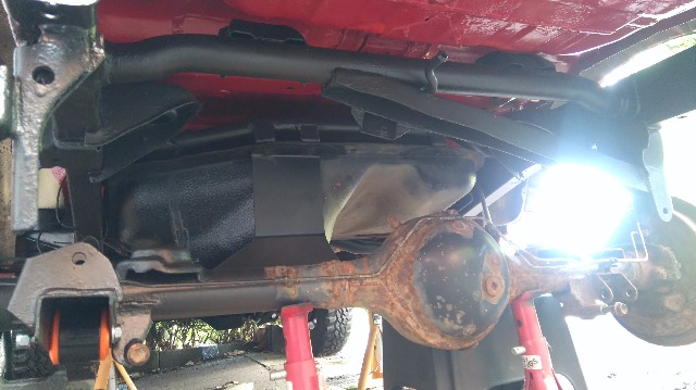

A lot of preparation and buzzweld chassis in one
Just need it to stop raining so i can fit rear arches and kap corners then mot time

Looking good mate! Ended up putting WAR on mine as was told CIO would react with a few other previous treatments that was on the underbody. How did you find the CIO? I like the back box.. was that custom made by you?

CIO i really like as it drys so fast
RCP is good too but never put it on thick as it takes days to cure
as i go along i'm removing all the factory underseal and using rcp then tractor paint case red
the back box is a proton savvy centre section cut up and re welded (straight through silencer)
