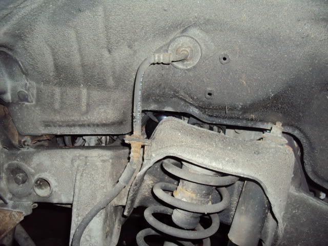

This weekend, I have done a attempt of fitting my 2" bodylift. Unfortunately without the result I wanted. I wasn't able to figure out number 5 on the list above: 5) make sure nothing is going to get streched and pop off or snap when jacking the body away from the chassis.
Here is the main reason, does it HAVE to be fitted extended brakelines when fitting a BL? How have you guys sorted this out:

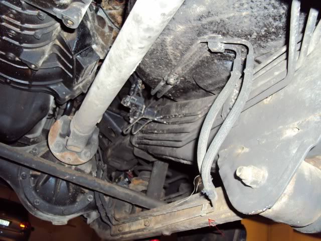

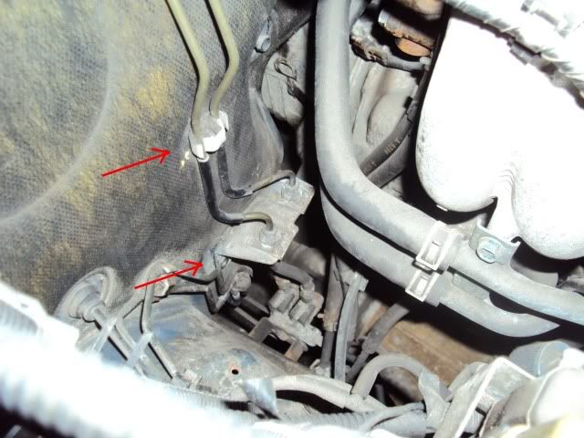

Next is all the piping, how have you guys fixed this? Refitted, or hanging loose? It is really tight here, so refitting is difficult. And man, I really hate those clamps. Impossible to release without breakage:
Next, is the routing along the radius arms. How is this solved best without having to rerout the entire system?:
