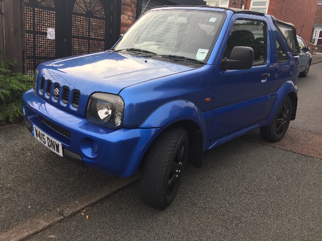

I've been trying to find a definite answer to the question on what biggest tyres I can fit with a 3inch lift? I was hoping I could fit 235/75/15s on standard jimny wheels but I keep seeing a few people saying 215/80/15s so can someone give me a definite answer please. I want to take it off road so I'll be getting mud terrain tyres
