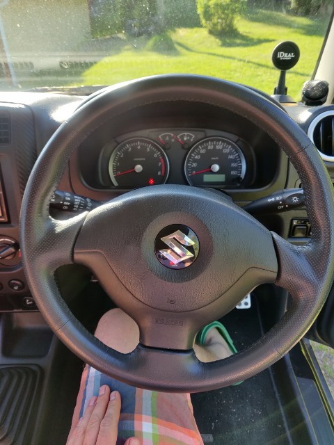

I changed my Steering wheel yesterday.
Went super fine. From a 3 spoke 2006 - 2014 JB43 model in leather to a 3 spoke 2008 - 2012 Swift ZD11S in leather with Audio controls on the wheel.
Required a bit of a fiddle but nothing impossible.
Pics attached
Quite satisfied. Wheel fits almost "straight out of the box". To get the Audio controls to work took a bit of thinking, but eventually I solved it relatively simple. My aftermarket stereo has learning function for different OEM solutions. Swift uses, like most Japanese, an variable electrical resistance to control all the functions.
Pics attached

This could be a good 'How to' article to go into the Wiki if you made a step-by-step guide

Yes, great idea. I took some photos of the operation so I will write an small 'how to' guide.
