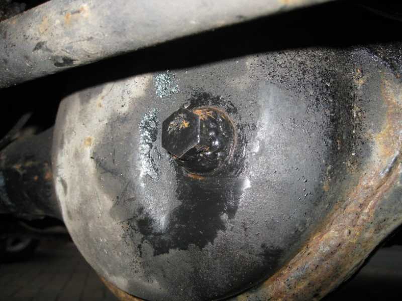

23 Jun 2016 07:36 #169036
by facade
Replied by facade on topic Diff filler plugs
There is a nylon washer underneath the flange as a seal, so be careful with the heat.
I tapped mine round with a chisel then did this:
(My stick welding is useless, but it has stayed together for years
