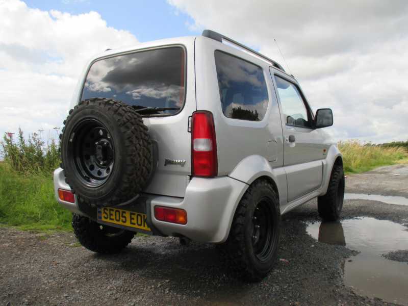

As you may know I am new to jimnys, got my first a couple of months ago and love it! First mod was out with the back seat and boxed it in for carrying tools etc, then tinted windows to help prevent prying eyes. Last week I saw an ad for off-road wheels and spacers! Ah I want them for the winter for on fields as I am into metal detecting and spend a lot of time on fields. OK deal done got the wheels and fitted them today to see how they would look. And wow! They look great! BUT on starting the car the ABS light was on! Ok maybe I disturbed a sensor? Off with the wheels to have a look, feck me! To broken pipes of some sort! Don't know how or why, they were rusted really badly so obviously had been friagile and maybe jacking the motor up had caused it? Not sure but it's happened anyway. After much searching and reading on the forum I am sure they are vacuum pipes for the hubs? So now what? Read a great and very informative post from kirkynut about converting the hubs to manual, what I need to know is this the road I go down next I am not sure as I don't understand what the vacuum hubs do as opposed to manual hubs?

The wheels look so good really transforms the jimny from shopping car to truck.
Hopefully someone can help with your technical issues.

what tyres are they and what size?
- Solas
01 Aug 2015 22:33 #148861
by Solas
205/70/15 kobras with 32mm spacers
Replied by Solas on topic Jimny not well!
Daniel30 wrote: Oh and looks good by the way
