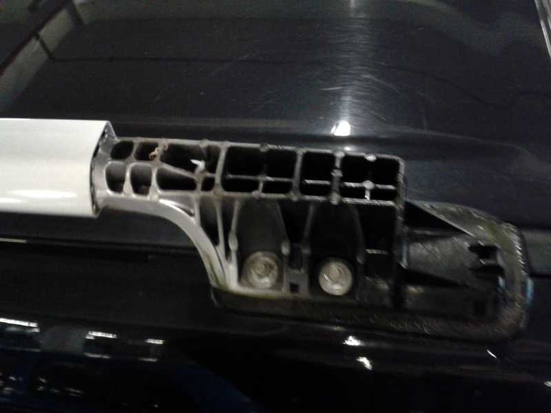

prise appart from underneath at the rail side then work your fingers along the length of the cap pulling and lifting carefully, caution though as any cracks or weakness in the cap will cause it to shatter .... :pinch:
M8 studs and nuts - 10mm spanner
this should save you having to take them off to measure

yeh, I'm making something stronger,
those are the feet onto which I've 1 inch dia tube x 3 inch long to weld on,
then welded on rails, then close the rails at the front and back
(a square/ rectangle frame, which will stay on all the time.)
then as required a basket/framework will simply bolt onto the frame
don't worry it actually sounds better in my head than the description I've given above :silly:
will post details soon as just waiting for a nice day and some spare time to get the MIG out
