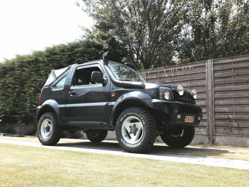

- JuanGuillie
30 Jan 2015 14:39 #136462
by JuanGuillie
Replied by JuanGuillie on topic Anyone got a Jimny on a 2 inch lift with 215/75/15 KM2s?
30 Jan 2015 20:56 #136504
by minibbb
Replied by minibbb on topic Re:Anyone got a Jimny on a 2 inch lift with 215/75/15 KM2s?
Some great looking cars thanks lads!
Have decided it's deffo the combo I want!
Should i stick with 0 offset or could I get away with -30 without issues?
