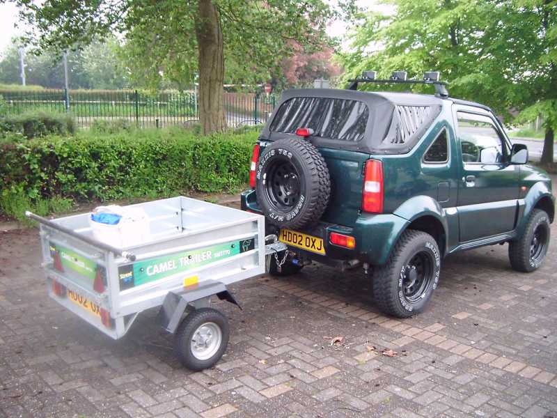

2002 JLX Soft Top
The following user(s) said Thank You: hunter1084

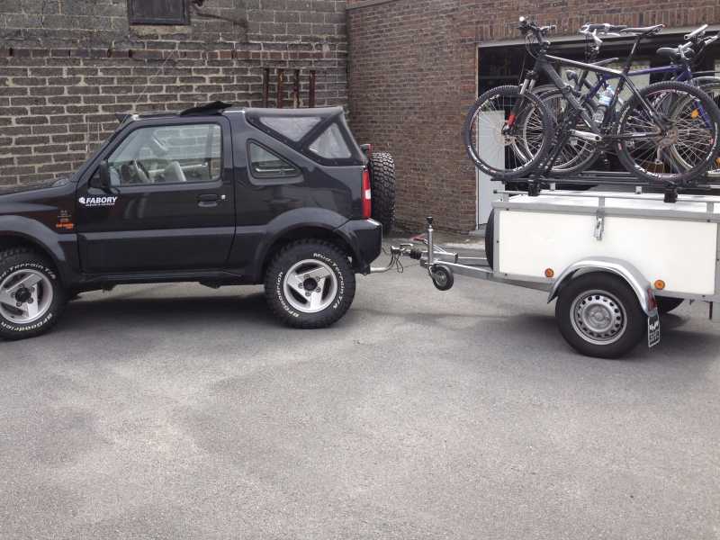

I bought a closed camping-trailer (max. load 750 kg.).
The normal price for this trailer here in Belgium is around 1100 € (around 885 £).
Then i changed the axle to a braked-axle for 200 € (160 £) so i payed about 1300 € (1050 £) for it, but for me it's worth every penny.
Certainly when it's fully loaded with camping gear and bicycles on it and your decending some mountain's like into the Pyrenees in France.
I feel much saver and have less stress during driving.
OK, 200 € (160 £) is a lot of money for a braked axle but like Busta did wrote (and sadly for him), entering a car in the front of you can cost you triple!
Just as a well meant advise, go for a braked one !!!
