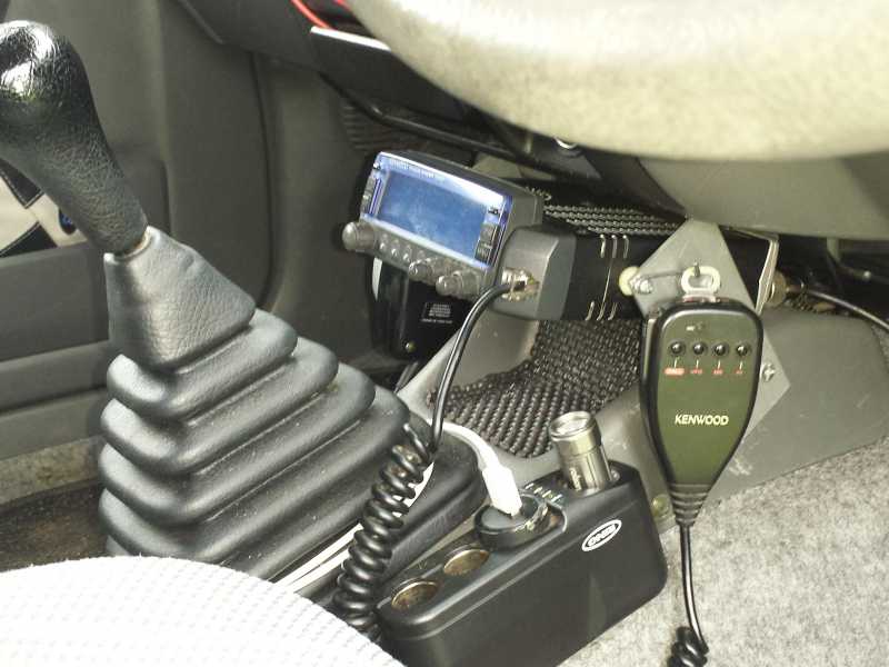

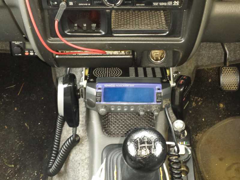

so after dinner saturday evening (while the misses was at work) i set to work deciding where to mount my new Kenwood, after much deliberating i decided under the ashtray was the most suitable place as i need to be able to see it (unlike my Cb which is stashed under the glove box).......... the mount supplied was not suitable for the task so i set about fabricating my own mounting bracket. some time went past as i worked on a design and sourced some suitable metal, screws etc from my old mans work shop and construction commenced.
heres 2 pics of the end result:
so saturday night resulted in me mounting the radio and running the coax to the roof via the fm aerial mount on the roof.didnt finish till late saturday night.

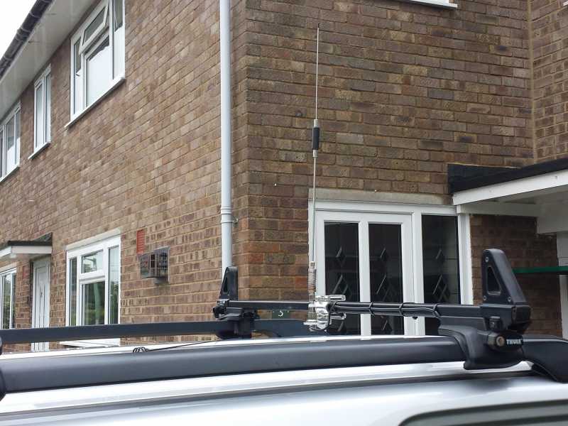

sunday morning i ran the power for the radio direct to the battery going through where the clutch cable goes and picked up some longer bolts for the antenna mount to clamp it round my roof rack.
the first picture shows the antenna ill use for daily driving as i dont need to worry about length:

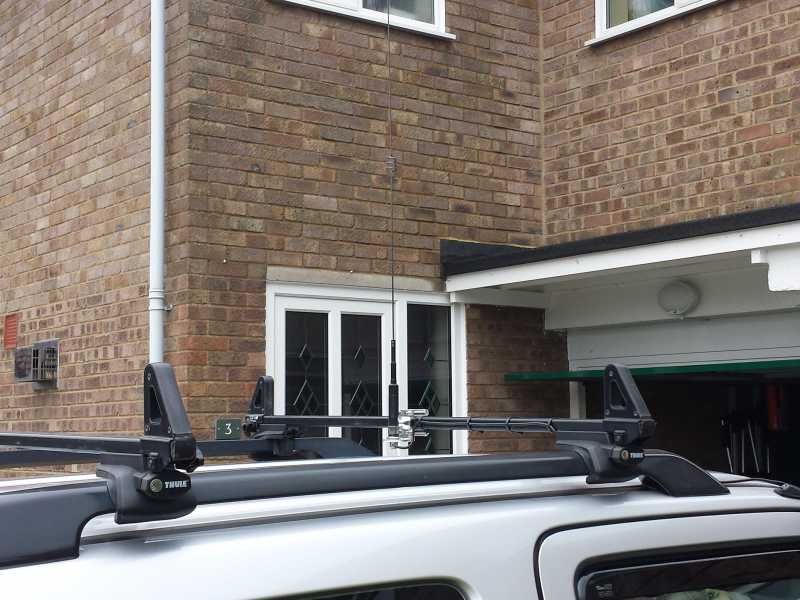

this second pic is of a cheap Watson MR700 with a 3/8 to pl239 adapter on a soft spring for laning (hopefully this will handle the trees and if not it was only £14):

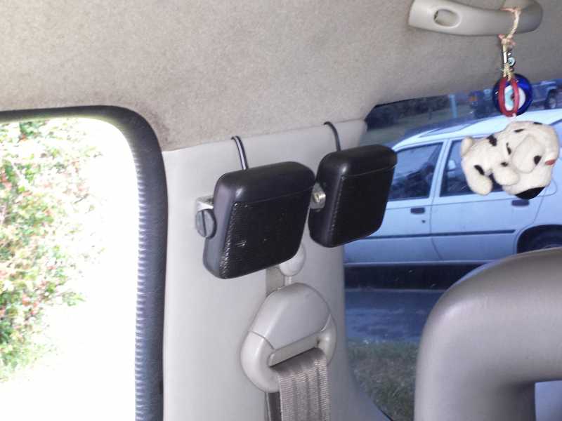

monday i fitted 2 speakers for the radio one for each band, had to extend the wires and strip the drivers side interior out to run the wires but im happy with the result:
