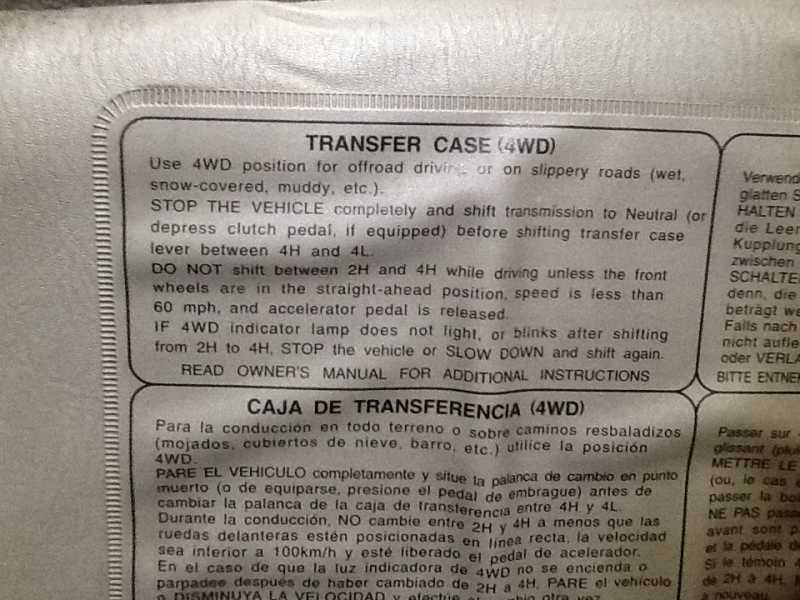

20 Jan 2014 18:18 - 20 Jan 2014 18:20 #101308
by mysterious
i appreciate ur reply. last winter i did it many times with normal shifting from 2wd to 4wd while moving in straight ahead-position as its writtin on the sun visor in a speed less than 60 mph .
this winter it didn't engage while moving in straight wheel direction and low speed . when i stop it works normal
anw thanks for ur advice.
look for the conditions writtin in this photo . WET ,SNOW , MUD...
Replied by mysterious on topic hard to select 4wd
jonesyba420 wrote: you shouldnt be using 4wd on the road even if it is wet!!
you may have broken something in the driveline.
only use 4wd if the wheels can spin ie lose traction.

20 Jan 2014 18:40 #101315
by mysterious
i think maybe that happened cz my RPM was about 1200. cz i start my engine ,wait for 2 minutes and drive directly but the RPM was still little bit high. cz its written accelerator pedal is released. maybe the system doesn't work on higher RPM.not sure if that affect on using 4wd

20 Jan 2014 21:21 #101348
by jonesyba420
Replied by jonesyba420 on topic hard to select 4wd
Its been advised on here to not use 4wd on wet tarmac, there is still to much traction.
