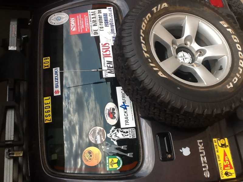

That's exactly the route I took from my spare wheel mount.
Once in the cabin, I just fed it up into the roof lining and forwards to the rig.
The rig is mounted just in front of the interior light, power taken from the interior light.
The SWR reading is as near perfect as you can get it. 1:1
Sorry, only pictures I have.

Here is what i did,
My cable goes from the spare wheel, down the door and then glued at the botom inside of the door, all the way down to the hinges, where is is then hidded behind the rear bumper mouldings, all the way back to the middle of the rear of the gar, where it enters the cabin of the car at the place where the stock jack is mounted, through a plastic round rubber, into the cabin between the seats to the radio, which sits behind the front seats,
My radio sits on the tunnel behind the rear seats,
Hope this helps.

Thanks very much to you both. I think a picture saves a thousand words, but to get such good desciptions as well brilliant.
Just hope its worth the effort when I've done. Living 750ft above sea level (even with squelch right turn up) you would be amazed the rubbish you pick up.
