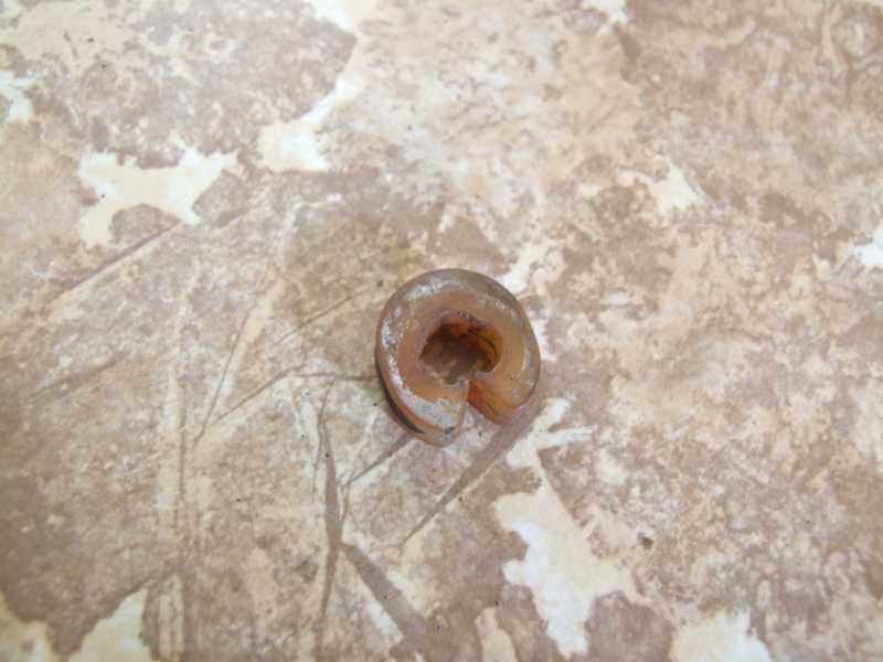

16 Sep 2013 11:15 #83347 by helijohn
Replied by helijohn on topic Brake balance valve
Got round to taking a second look at this and whipped off the insert that the spring hooks on to. I think the front brakes have been doing too much of the stopping.
A close look and you can see the insert has worn away on the inside edge so I have put an insert in there to take up the wear and add a mm so it gives a little more pull on the spring which in turn makes the rear brakes do more. Just wish I could go back to the rolling road to check but I think I'll steer clear until next year. :laugh:
