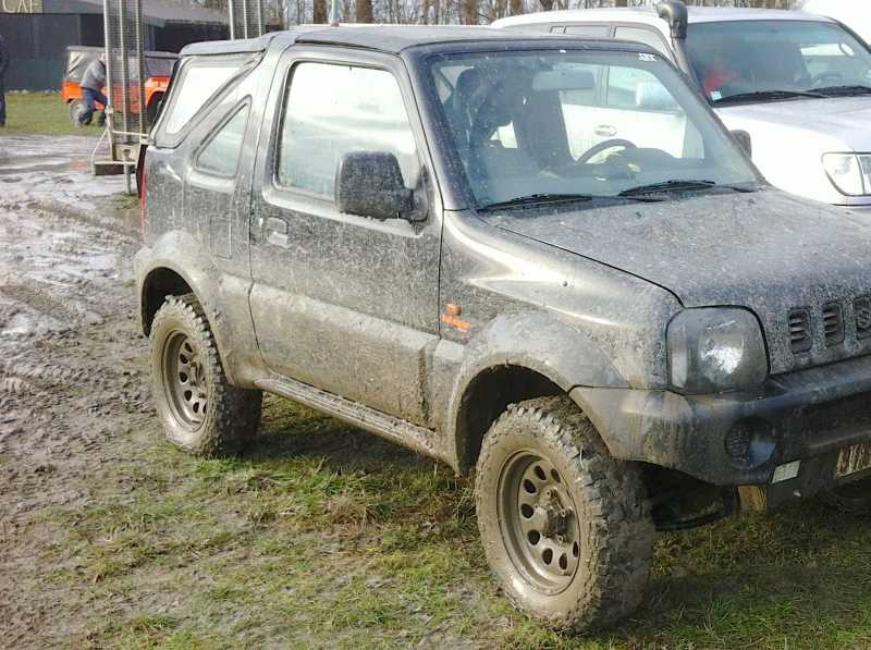

If you do a lot of roadmiles i certainnelly would not buy remolds !!!
For good road and offroadtyres in standardsize i did had the Maxxis Trepador 205/70/R15.
Very satisfied with them, even on wet roads.
On the picture you see them with a 2" Trailmaster lift.
I sold them to a friend who has a Samurai and he also say's it has better roadhandeling now.
Because i wanted more groundclearance i did go for the BF Goodrich TA/KM2 215/75/R15.
Also a good tyre for on- and offroad.
You better spend once a little bit more money and not buying some remolds that can have the problem that your Jimny will be bouncing around because of a possible uneven outline, certainnely after a long trip on highway or road.
