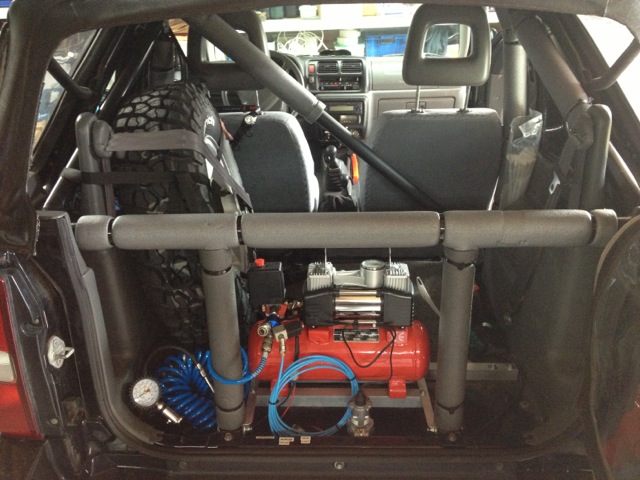

It's like Supergaz and Maverick said, a rear-diff locker is one of the most interresting mod's that you can do, together with good offroad tyres.
I also did put a Centreforce Dual Friction Clutch, that gives me much more grip then the standard clutch.
I have a ARB-locker in the rear diff, very satisfied with this choice!
In the picture you see how i changed the interior and mounted a little compressor for the ARB-locker and possibility to blow the tyres.
Also an interior roll-over bar (an exterior is not allowed by Belgian MOT).
Fitted the spare wheel at the inside, like this there is less weight on my back door and behind the rear wheels.
When not offroading i still can put the backseats in, and then i put the spare wheel back on the backdoor in about 15 minutes.
