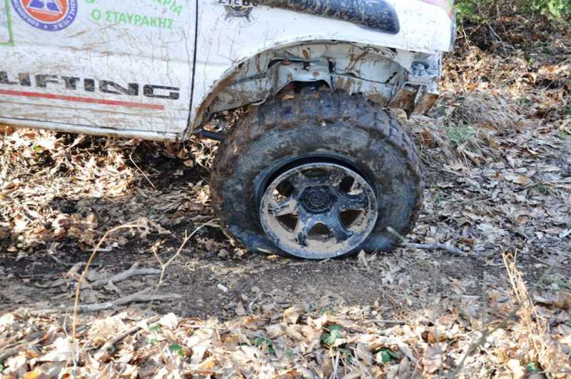

If you want to do it so ever, in my opinion you sould do what a friend of mine did
Dispite the fact that he has lc axles, he uses 33'' and the axles are at the original jimny place.
And his lift is about 3''. It looks so high because of the trimming.

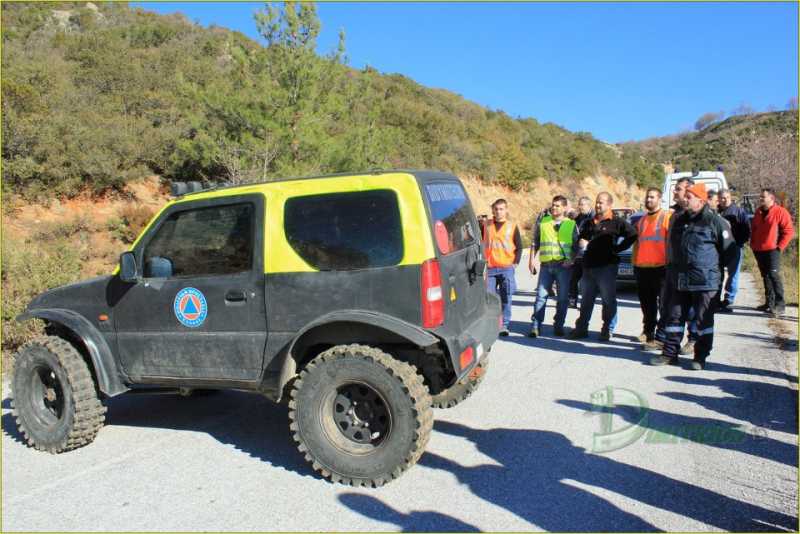

Another one with 235/85/16 but more discrite
It's the best but also expensive way to do it. If i remember he paid for both front and rear 800Euros.
