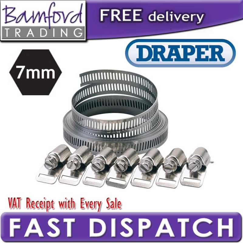

It,ll definitely be the heatsheild on the cat, I've got a bit of this round mine, buckle at the top to stop it catching.
from fleabay or your local motor factor/accessory shop.
John.
John.

01 Mar 2013 17:54 #64288
by JivingDaddy
Replied by JivingDaddy on topic Rattling Jimny
Ooh, never thought of that. Very tidy Johnnie
