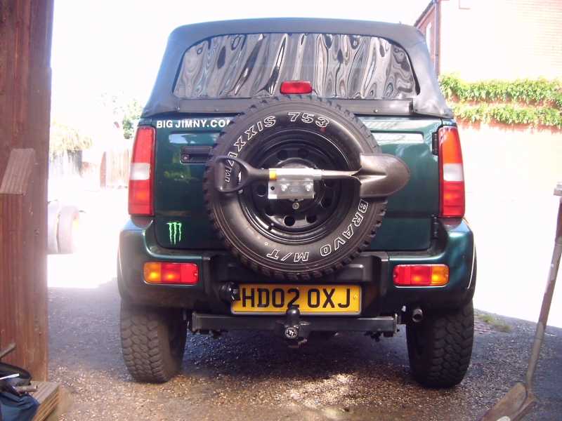

anyone know what the biggest size of spare wheel you can have on the jim without it hitting the bumper etc? thinking of getting another 215/75/15 mud to have on the back

I got a 205/75/15 fitted on my jimny and that's ok so a 215/75/15 should fit with out hitting the bumper.

Dan you could also buy 3 of the wheel spacer studs from Jimny Bits
(Grayston wheel spacer replacment extension studs)
to move the wheel out from the bumper, this would allow pretty much any size to fit.

iv got the bits for vits spacer with a 205/80/16 on the back door
