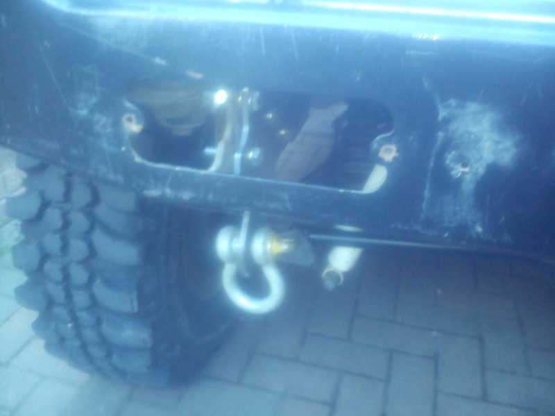

supergaz wrote: Special order ORA recovery points to suit the older MK1 rear bumper, I had these ordered to suit a +2" Bodylift.
If you have the MK1 rear bumper, then these are the best recovery points to have. :P :P :P :P :P
I re-drilled the original brackets to sandwich the chassis with the new recovery points, also getting the bolt into the bottom hole on the chassis required someone skinny to reach into the chassis rail, so I welded a piece of bar to the bolt so I could get the bolt in place and to enable me to tighten it all up.
These are not on the ORA website, But contact ORA if you want some ;)

Thanks :) Looking good.
Sadly, looks like these recovery points won't fit my Jimny as I have fitted a towbar. Still have the original bumper. But perhaps one day, ORA makes a rear bumper with recovery points welded on, like the front bumper :)

The newer rear bumper has recovery points similar to the front bumper. I'm not sure if it would fit with a towbar. But worth a look.
