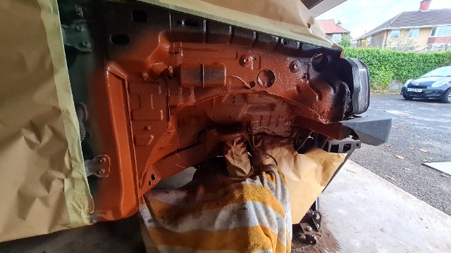

Today I scrubbed up the driver's side wheel arch and inner wing. There are no inner-wing covers until I make my own, so I got the WAR buzzweld paint out and lathered it.
I also did a few patches of welding on areas that were a bit thin near the body mount. All in all, a good few hours to keep little Jim going for a bit longer.
Rust encapsulator paint (primer)

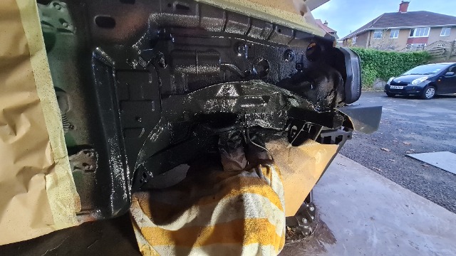

Black WAR paint Schultzed on nice and thick with the air compressor.
