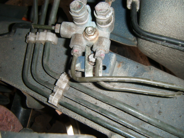

I think this is what supergaz meant by watch the brake lines on the O/S/F you will need to make a bracket when you undo the bolt and lift them up.

Well tomorrow is body lift day guys! Thanks for the pic great help

dirtydogz wrote: I think this is what supergaz meant by watch the brake lines on the O/S/F you will need to make a bracket when you undo the bolt and lift them up.
Thank you.....
Very good solution.......... :) :)
My solution for the rear line (coils spring + 2 1/2")
Gustavo
