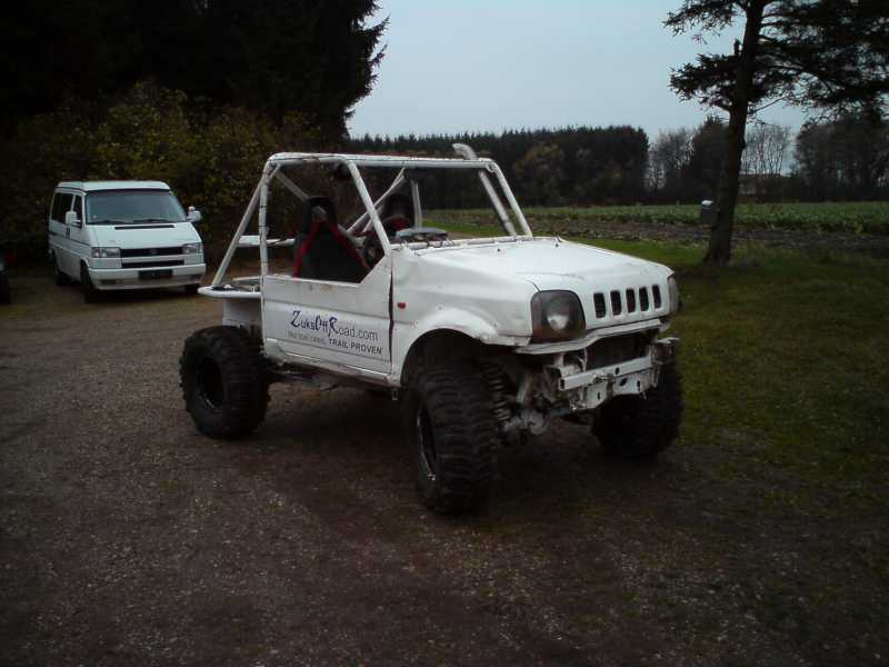

why run lr axles? tought they were week... nissan patrol axles are VERY strong but mabee to wide and hevy?? after newyear i´m mounting sami axles under my jimny. ora sell mounts that will fit. I´ve cut coil- and dampermounts off an extra jimny axle to use on the sami axle.
sami axle is with tg hd cv and shafts. front and rear arb.
running 5,14 transfer and 31-12,5-15 boggere.
jimny is still on jimny axles.
