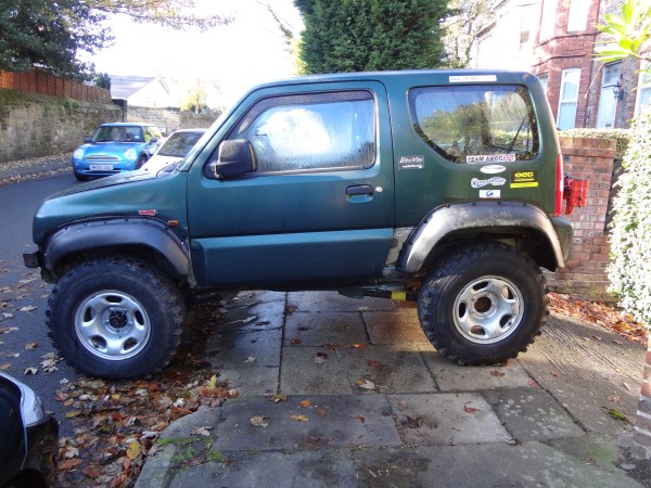

hi iv got a 3"spring n shock lift and running special traks 235x75x15 they rub front wheel arch when very crossed up only a little tho n its a little im doin 1.5" body lift kit after xmass then she will not rub sorted !
note specail traks come out little bigger that a standed 235x75x15 as have little more tread deth they come out just over 31"

215/75/15 or 235/75/15 but with the lager of the two tyres you will need to trim the front bumper.

I agree i have 215/75/r15 on mine with a 3 inch lift, all is well, but any larger and the trimming or a body lift would help ! Im still gona trim my bumpers !
