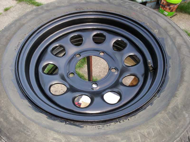

I use Wilko paint and apart from gold I use black. I have painted many including alloys - the prep is fairly important but it is no more than a rub down and sometimes an undercoat. I make a hoop of cardboard that sits on the outside edge of the rim where the tyre meets the rim; it can be swapped to each wheel as I work. Also I have a small piece of hose pipe to mask off the valve.
The last wheels I did were for my Junior and were in a fairly bad state though I have had worse.
I decided to try an undercoat
then the Wilko paint
And here's my Rav - before
After
After
