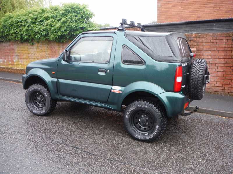

With all this considered, I think I'm still going to chance it with the Maxxis 753 Bravo in 205/75 and see what happens. If it doesn't fit I'll shout a swear word very loudly and take my Jimny to a local body shop to see if I can get the bumper cut more neatly than I can manage (as in so it looks like it was meant to be that way).
