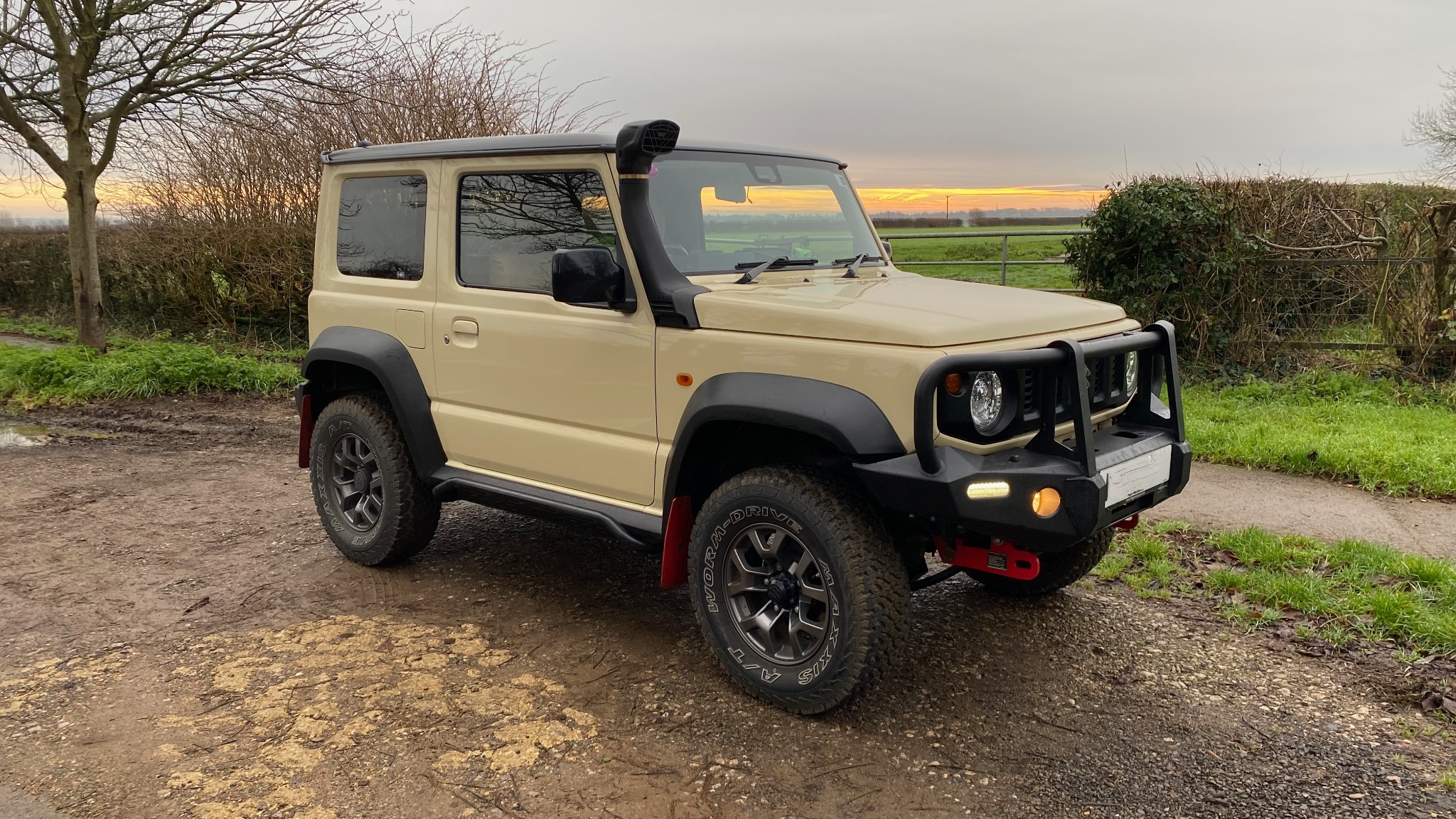

I'm not familiar with all of the bits, I'm also in the UK. But by and large the list all looks reasonable.
What I would say is, if you plan to off road the Jimny has a couple of weak areas. Firstly in ground clearance and secondly in suspension travel. They are both pretty limited in stock form.
The OME kit is meant to be high quality and I suspect it will ride and handle very well on road and probably on tracks too. But the lift is minimal and it won't really give you any improved articulation. So its benefits to off road performance are limited beyond the improved damping.
I fitted the Black Raptor Premium 2" kit to my Jimny, I think you can get this in Oz.I was very impressed with it. A proper 2" lift that increased the suspension articulation, giving a much more stable vehicle off road. The shocks are also top quality and adjustable, which might be handy if you are towing, as you'll be able to tweak them to the conditions and weight and readjust later when not towing.
IMO with the 2" kit it handled and rode better everywhere over a standard vehicle; on road, off road etc. And was a more capable machine because of it.
As ground clearance is an issue I'd also recommend some under vehicle protection such as a skid plate for the transfer box and radius arm mounts. They are very easy to impact and get hung up on.
Lastly tyre size. I had 215/75R15's on mine too. And they were fine. But later on I switched to 235/75R15 and they were much better IMO. I wish I'd gone for that size originally. With a lift and non factory bumper they should fit fine. If you are an auto it might impact performance a bit, mine was a 5 speed manual and I couldn't really tell much difference if I'm being perfectly honest.
