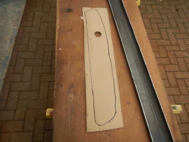

Wheel off and supported with an axle stand, to get to the rear of the cab...
Some more CAD (Cardboard Aided Design! :laugh: ) with a Corn Flakes box (other breakfast cereal boxes are available!
Holesawed a hole for the rear bed tube and slipped the template into place...
And then went right the way round banging the cardboard with a rubber mallet...? :blink:
So that I can see the groove, that's the shape I need!
Cut it out with "Manly Stanley" (Yup, most of the tools have names!) :lol:
And test fit our cardboard template...
Then pop that on top of the half piece of rectangular box section and draw round it... remembering that we need to cut and fold INSIDE the line so that it will fit into the rear of the body tub...
Like that...!
The bottom piece cut and trimmed to suit also...
Clamp, Weld, Hammer, Clamp, drink tea, repeat...
And we eventually end up with
Yup, happy enough with that...
Stand back and admire the matching sides...... and home for a shower and a Stella (together of course)... and tea and an evening with the fam'...Content in the knowledge that the other half of the rectangular box section is waiting to be trimmed and coerced into fitting into the top of the half door on Wednesday... :woohoo:

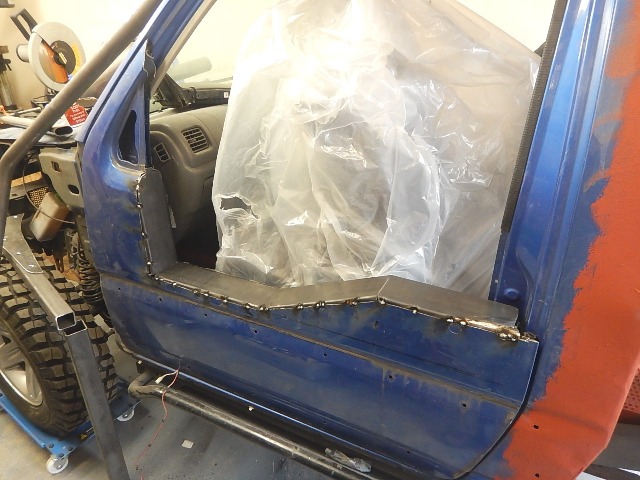

Started on the passenger door today -
The other half of the 4"x2" box section carefully measured, shaped and "bent" to the correct angles...
Some accurate measuring there if I do say myself :woohoo:
I was so happy with the fit and placement that I tacked it in place...
And then realised the welding gas was running out, so I went and fetched another bottle ready for Sunday
I returned with a new gas bottle and clamped the inside ready for Sunday too...
So just a half day today as I had other things to do, and it's "quite quiet" Wednesday as our eldest daughter is still with us working from home in my study above the garage...
More noise on Sunday though! Welding, grinding and sanding that door 'til I'm happy with it
