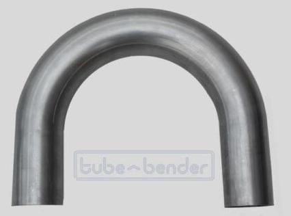

Sat with a can of Stella last night (as you do) and placed my order...
Changed my mind last minute and bought two hoops to my size for the roofline guard, and a right angle bend to go around the fuel filler, and one of these -
to mount the top fairlead in...

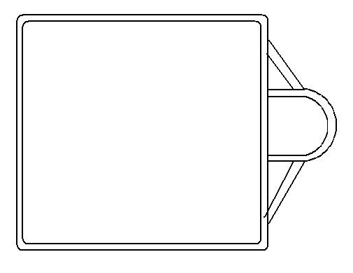

13 Mar 2020 15:24 - 13 Mar 2020 15:25 #219822
Quick sketch of the revised hoop around the roof line -
I was going to the add some sheet steel in the back bit to hold the little fairlead I have.... but as I drew it I thought, no it doesn't need it, as the winch rope will run nicely over the hooped seamless steel tube... just like one of them Ultra4 buggies (Lambert)

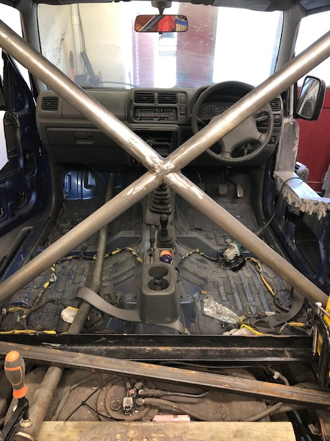

15 Mar 2020 22:22 #219901
16 Mar 2020 09:13 #219914
by sniper
Replied by sniper on topic Dave's la(te)st buggy build...
Pretty heavy tube for a small welder.....
Remember to structure the weld on heavier jobs........ Root - Fill - Cap..... Makes for a stronger weld than just blasting it in and lets you run the set a little lower. Heat input is lower also which is always good news.
Looks great as always Dave, I look forward to seeing it in the summer.
sniper
sniper
