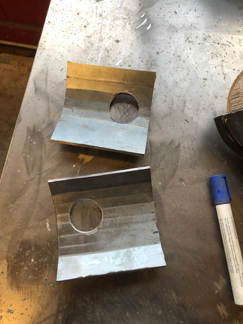

I began by making a gusset plate for the top of the roof hoop on the passenger (Alan's) side
And having drawn around all the fixing points I ground them back to shiny metal, and then re-assembled for the last time, ready for welding...

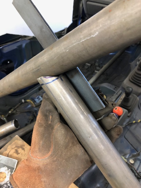

Notice the flat bar welded to the 'main' crossbar?...
You can just about see it there... that's to line up the other crossbar after I've cut in in half...
I marked the centre line, and then the start and end of the 'fishmouth' cut...

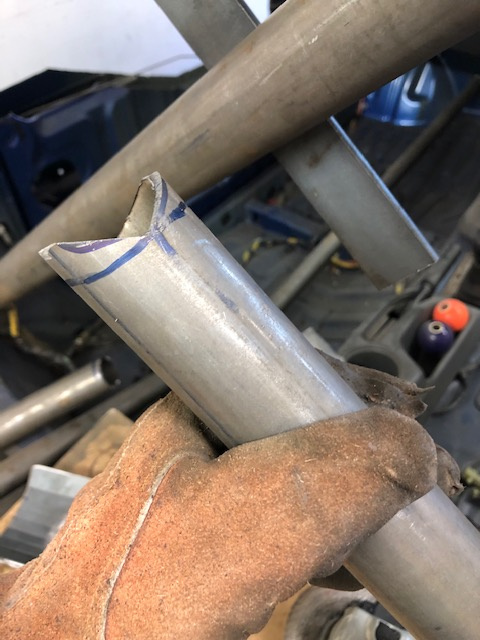

There on the bench you can see it better, just a flat triangle cut to start it off...
Like that...
So that roughly fits around the 'main' crossbar, and then attack it with a grinding disk...

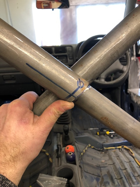

So that we get a nice join like this
And then bring in the other half again, and mark that up...
Repeat the fishmouth cutting and grind, et-voila!
And we have our X crossbrace in place!
