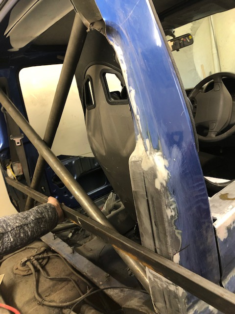

Keithy's previous comment about CAD "Cardboard Aided Design" leads to the use of plastic pipe... easier to make a mistake in cheap plastic waste pipe before finally cutting the expensive seamless tube when I'm happy with the fit of the plastic one! ;)
Spreader plate
And the other end... the other spreader plate. The smaller diameter tube comes through the roof skins and will be plug welded into the main X brace which is bigger diameter and will be butt welded up to the spreader plate, with the smaller diameter tube inside, so nicely braced in a couple of ways... (The smaller tube will be holding the tree scrape bars that will surround the roof line like my old Blue Jimny had... to lean on trees and push them out of the way! ;)
Happy with the fit using the plastic prop, I began cutting the seamless tube to length and shape...
And mocking up the other end... it's a bit cock-eyed yet but I didn't want to tap the smaller diameter tube in too far for fear it wouldn't come out again! :ohmy:
There, the main brace is in...
Happy with that I tried it the other way and then copied it to make another one... the second one will need cutting in 'half' and fishmouthing around the main brace yet...
Some box section will then be used to make a small back wall up to the level of the back of the half-door where it rises up, that will then give the buggy a 33" wading dept up to the level of the lower section of the half-doors, should be plenty?! It's well known I'm not keen on DEEP water! :lol:
Hmmm, all this started from starting to mock up a base plate to hold the spare wheel up! I needed to see what angle it could sit at to get it as low as possible for rear vision, both in the mirror and turning round to reverse, etc... With the cage in place the spare can be angled back against the X to work out where to make the base plate for it... the Y ratchet strap also arrived last week too...
